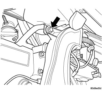

NOTE: The 1.6L is attached with a rubber isolator system. Care must be exercised in retaining all the pieces and reinstalling in the order they where removed.
1.Disconnect the negative battery cable.2.Disconnect the electrical connector at the throttle body.3.Remove the purge hose from throttle body.4.Remove air cleaner assembly cover and disconnect the inlet air temperature sensor.
5.Remove the 4 mounting bolts from the upper to lower manifold.6.Remove the PCV hose and the brake booster hose from the upper manifold.

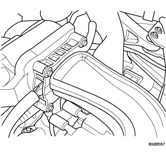

7.Remove the 2 bolts to the upper manifold to struts.
8.Remove the 2 bolts to the upper manifold to struts.

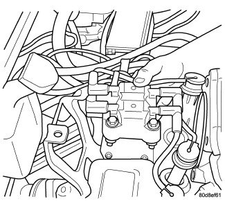

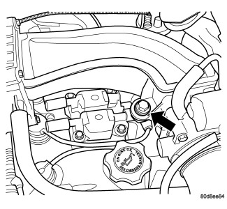

9.Remove the 4 bolts from the ignition coil .10.Remove the spark plug cables from the ignition coil.
