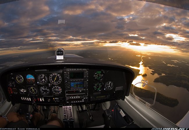

Diamond DA-40D Diamond Star TDI aircraft

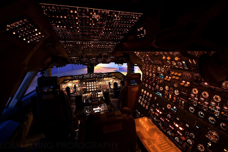

Cockpit of a Boeing 747-200
